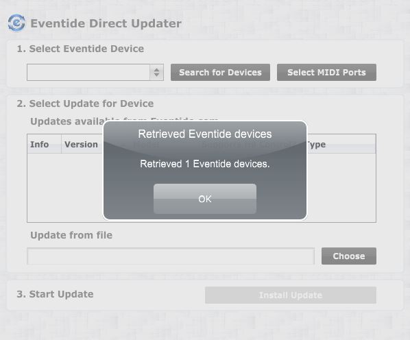

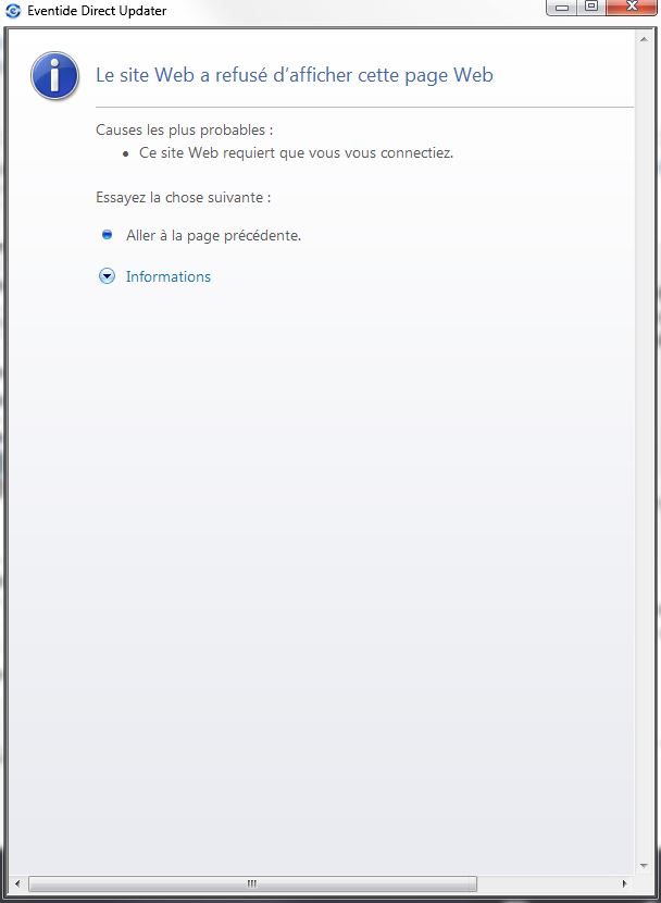

when i arrived in updater, my Sp-14061 was retrieved (Step 1installing issue 3. Step1.JPG), i tried to see info on update but it didn’t manage to load an info page (step 3installing issue 3. Step3 no info on update .JPG) ,

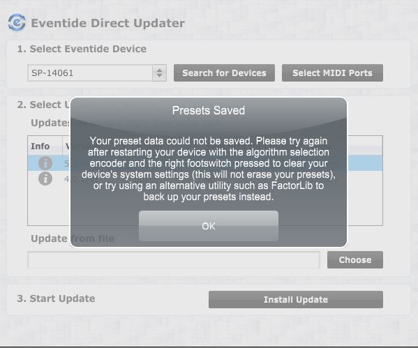

then i “install update” it ask for backup pedal presets, i choose a file, ok then an error comes (Step 4installing issue 3. Step4 loop error preset data unsaveable.JPG) and ask for “Clear setup”… ??? i just did it before, why ?
so i did the same “clear setup” again (don’t think, be a computer lol) and relaunched “search for devices” and “install update”
this time all did well (saving presets & lond update transfer and install) !!! good

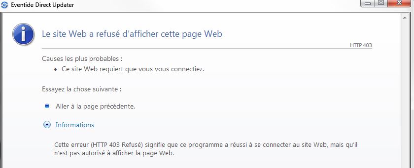

and i still don’t understand why i can’t have info when i click the round (i) in updater, it tries to connect but can’t (attached step 5installing issue 3. Step5 error connecting.JPG) is this why i don’t see 5.4.0 as available ? connection problem ? do you force a particular browser (i use firefox and i am web-connected when trying) to see info on update when a new page pop-up ?
