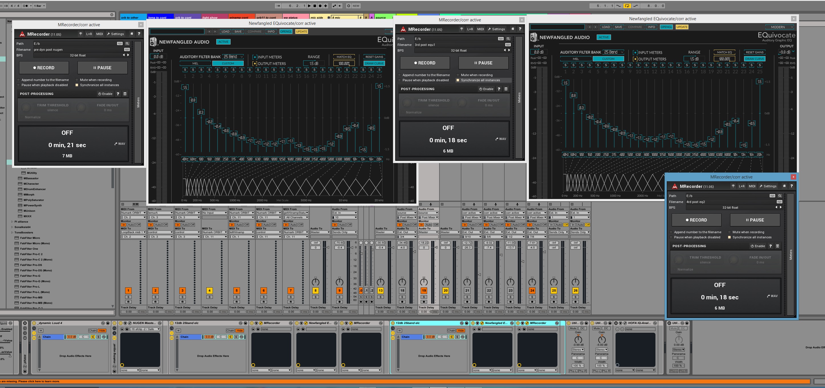

ok so I am supplying screen shots of the problem
here is the chain with MRecorder plugin capturing signals pre and post each instance of Equivocate.

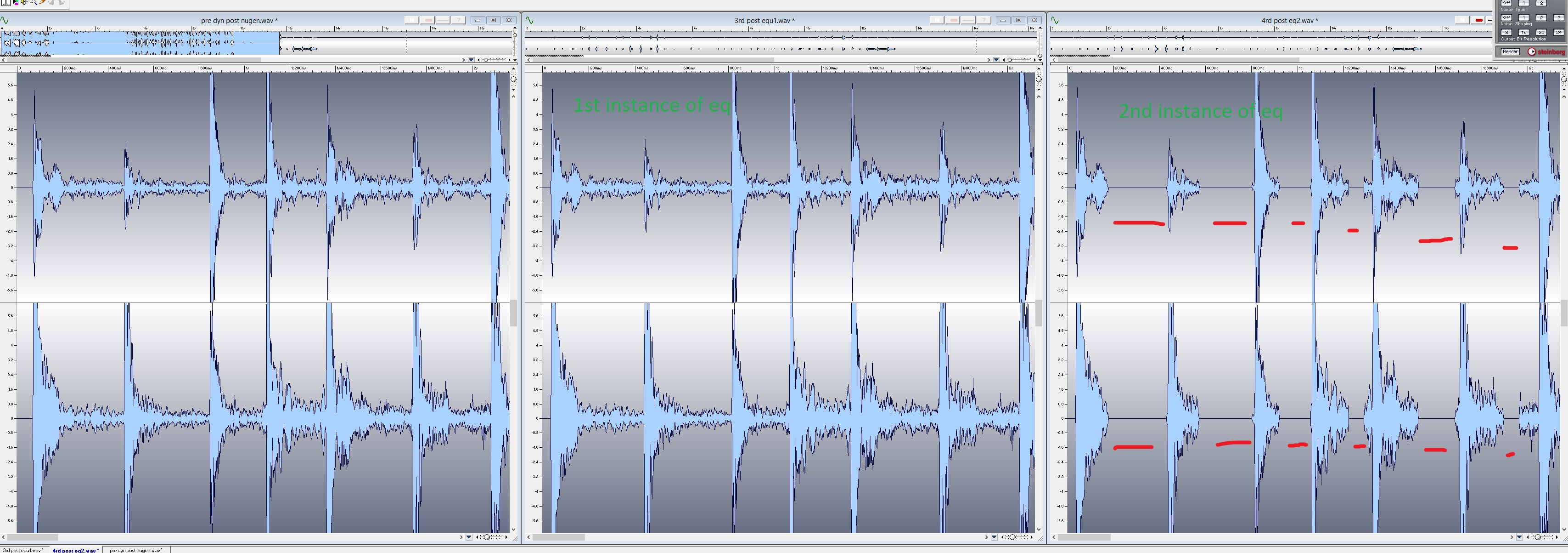

and the level normalised results of the captures.
I am unsure why the mute/ gate occurs in the signal (see results marked in red)
Please note this chain produces no gating when the input signal is higher, ie increse gain before plugin chain.
