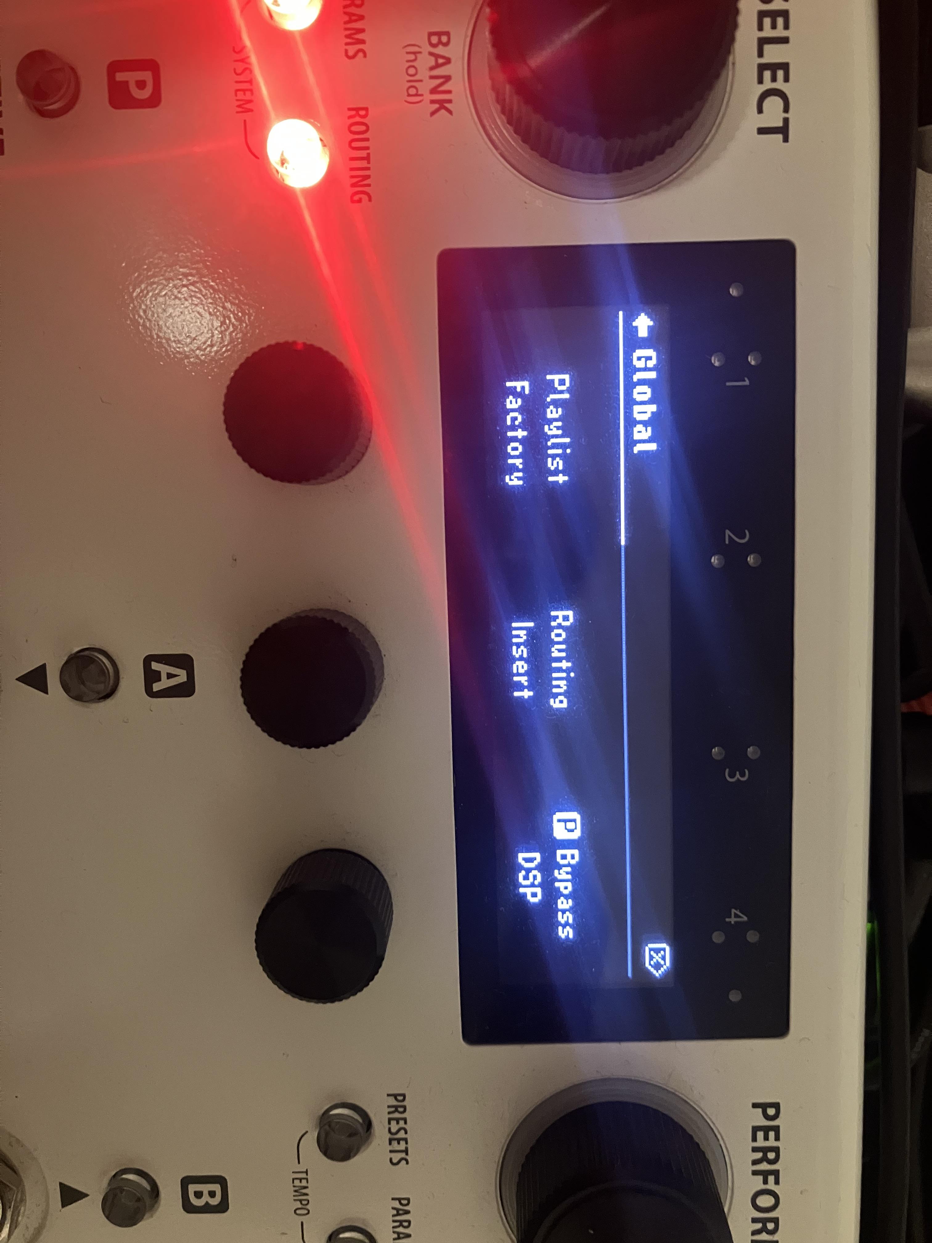

Hi folks,
Since updating to the latest h90 firmware I’ve been having some issues with fx tails and insert routing when I’m activating the tuner. No matter which bypass mode I’m in effects tails and my inserts (stereo ins at the end of the chain on channels 3/4) are muted – there is also a [P] next to the bypass modes in the global menu which I swear didn’t used to be there and I can’t seem to see reflected in any of the manuals or documentation. (photo attached)
any ideas on how I can get fx tails and inserts to pass through while muting input 1 when tuner is activated??
