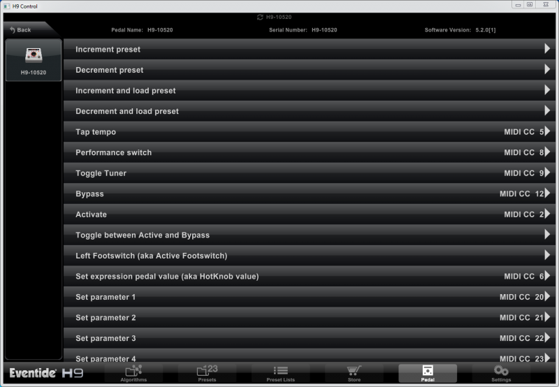

            We're having trouble reproducing this.  Are you doubly sure none of your MIDI CC mappings under RCV.CTL in the H9 itself are mapped to BYP, FS1, FS2, or FS3?

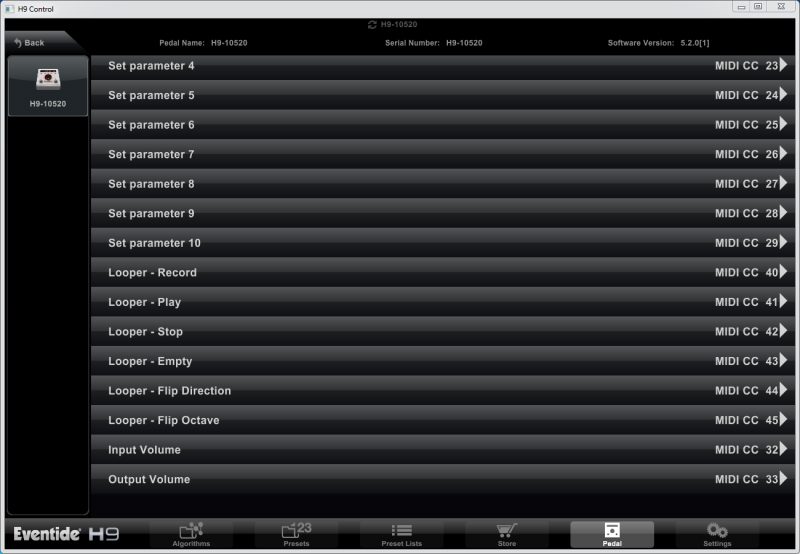

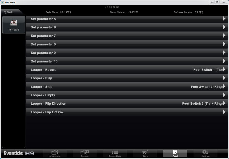

          I’m attaching my MIDI and AUX mapping here.
          Please note that I’m not using MIDI + AUX at the same time. But I will disable those AUX mappings and will check if the problem persists.

              I had intended to try this out for a while now, SpaceJam.  I went as far as nearly duplicating your MIDI assignment screens in H9 Control, and MIDI ‘Learned a CC #44 to Looper – Flip Direction in the H9 itself.
              I’m sending CC messages with an FCB-1010.  Various static values using the footswitches; performing as expected.  Continuous values of CC #44 via footpedal stuttered the loop until the values settled down.  Also expected: the Looper is trying to incrementally flip directions under a barrage of MIDI CC values.
              I don’t see anything wrong in your MIDI assignment images.  On the off chance that the LF Mini was sending MSB / LSB MIDI CC’s, I thought there might have been a CC #16 “clue” somewhere.  This is baffling …  I can’t reproduce the issue.  Have you used a MIDI monitor to check if the LF Mini is sending anything else unusual?
