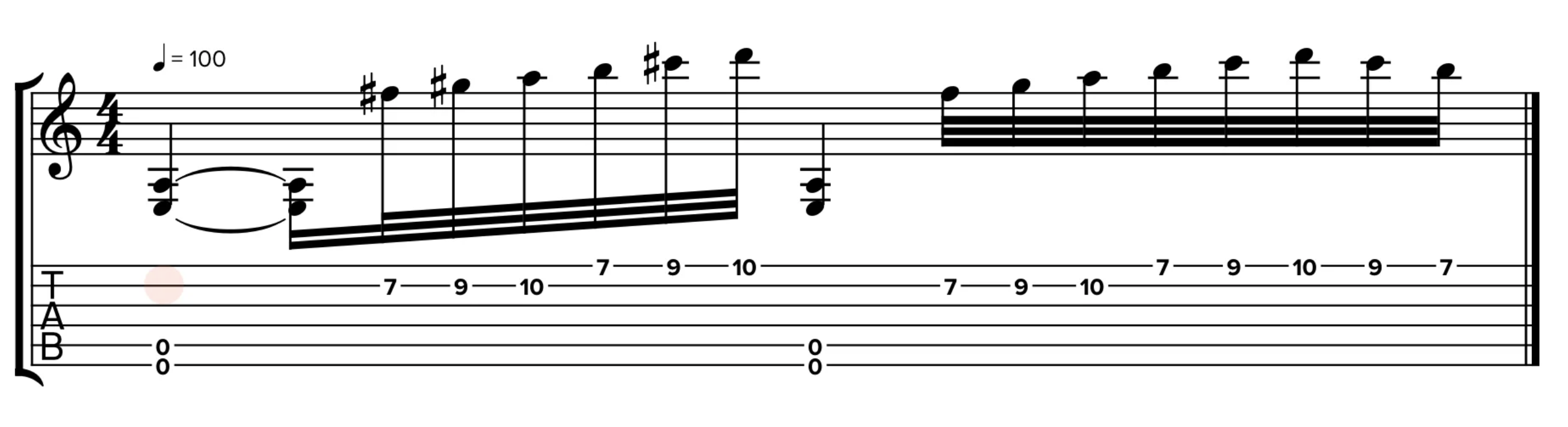

        I have a section in a song where I need a dual harmonizer. That’s easy enough but the thing is that I need to be able to engage it with a single footswitch for about half a bar (the high notes), and when I let my foot off of the button, the effect is gone so I can do the chuggy bit. It’s done quite a bit in that song. I posted a pic of the section below just for clarification purposes.Screenshot 2026-09-10 at 2.05.32 PM
        I do it on my AxeFX setup, but I need to be able to recreate it with my Fractal AM4 rig. There are a ton of things I’ll use the H9 for overall, but I need it to do this specifically.

          If I’m understanding correctly, several ways to do this, set up as momentary switching.  For example, a Preset saved in Bypass, with Active (M) kicking it in.  Or a fully active Preset, with a HotSwitch (M) that only punches in the harmony.
          This would all be found under the Perform pages for easy access on-pedal.  Most latching controls in the H9 Gen 2 have a complementary option for momentary triggering.

            Apologies, I should have specified that it’s on a momentary switch. I know in Fractal-Land, it can be done with the “Pitch Follower” but it’s not as clean as I would like. Doing it with the switch is clean but tough to replicate, but that’s why we practice lol
