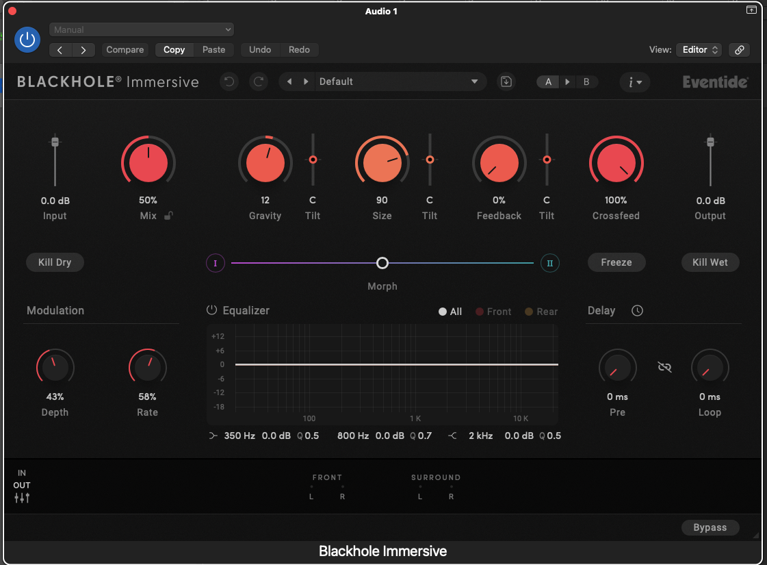

          If you are only seeing Stereo input meters, then you may have the plug-in enabled on a stereo track. My screenshot below shows what the plug-in should look like on a Quad track.
          Screenshot 2026-05-14 at 10.15.07 AM
          Note that if your Logic settings are configured for Quad, you can start with a stereo track and place Blackhole immersive directly on that track. You should see the option for Stereo > Quad which will allow you to upmix the stereo source into the Quad plug-in using the panner in Logic.
