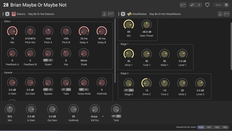

I don’t know what everyone’s tried or heard before in Diatonic. Of course it’s important to select the matching Key & Scale, and the harmonies desired in Pitch A & Pitch B. Stick to single-note lines and simpler double-stops. But it’s equally important to simulate the multiple guitar overdubs.
Add up to several dozen milliseconds of delay time, with Delay A offset in time from Delay B (and also from your dry guitar). Balance between the harmony voices with Pitch Mix. Use an EXP pedal to slightly vary Pitch Mix to either side of center at A10+B10. That will a little greater emphasis on one or the other ‘overdubbed’ voice.
Here’s a quick example I tossed together that may give you a head start. Quant is OFF in Diatonic, for more forgiving string bends & wider vibrato. The Weedwacker instance in Series is optional. I just used it to push the midrange, and add some hair to the output.

After a little more thought & refinement … I attached a Program here to get you started.
- The three HotKnobs adjust the effect mixes, delay times and distortion components.
- EXP pedals vary the Pitch Mix in a subtle way, or add Feedback to the delay lines.
- AUX or HotSwitches change up harmony intervals, for 3 variations on the base Program set.
I like the idea of using momentary switches to do hammer-ons & pull-offs, much like a Digitech Impossible or HammerOn pedal can do. They’re easily accessible, and help to break up the static nature of the ‘overdubbed’ guitar voices.
