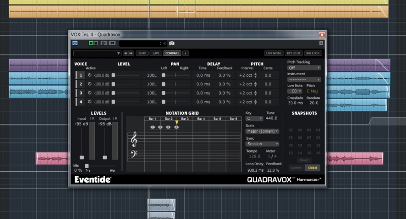

      I am having a very annoying bug regarding my Eventide plugins. This happens with both Quadravox and 910. I can insert them in my Cubase 10 sessions without a problem, the plugin opens and it starts working correctly. But as soon as I try to tweak ANY of the controls, the control is automatically irresponsive and it locks at zero, or at the lowest grade in the scale. This is what happens as soon as I try to change any of the plugin’s parameters (in this picture I did it to all of them). As soon as I touch any of the faders or the figures, it goes like this:

      Thanks for reporting, and sorry to hear about the issue – it's not something we've encountered before. Myself and the other engineers are away for the holidays until the new year, but we will look at this ASAP when we return.
      As a temporary workaround, if automation is working ok, you could likely use the generic plugin editor to tweak the parameters, though of course I realize this is not ideal.

      I’ve been trying to reproduce your issue with no success. Would you please be able to reply with your email, so I can contact you directly to better understand the case and try to lead you into solving it ?

      Hey Tom, thank you very much for your answer. I get that it’s a tough time of the year to be reporting bugs lol, but any suggestions will be greatly appreciated. Enjoy your holidays!
