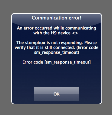

        I get this error whenever I connect my timefactor to the H9 Control for Mac. I have Mountain Lion and it’s properly connected via MIDI to USB and still nothing. I don’t get it. HELP!!

          Not sure what you  mean by "connected via MIDI to Usb." I suspect this is not what you mean, but, if it is, suggests that you have a complex hardware setup that may be the cause of your problems.

            Humm not sure here either, but for this to work you connect your Mac using ONLY an USB cable to the Timefactor. (page 53 of the manual). You DO NOT use the midi ports with the H9 control software.
