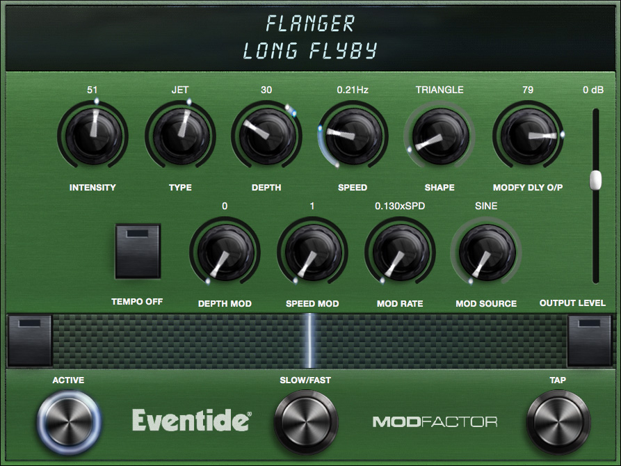

        All of the ModFactor algorithms (plus other ‘Factor categories) can be triggered / shaped by input level.  Often, in two different places.  Essentially, anything with a MOD SOURCE or SHAPE parameter.   Set it to ENVLOP [ENV], or ADSR.  SPEED will become SENSITIVITY [a critical adjustment parameter].
        For control over delay time, the CHORUS (and, yes) FLANGER algorithms immediately come to mind.  Adjust the MODFY DELAY O/P for the delay time in FLANGER.  Crank the initial INTENSITY control.  TYPE will figure very heavily into the final effect, as well.

      Upper-right; top row.  In the Flanger.  Think of it like the MANUAL (delay) time in an MXR 117.  I thought I posted a couple of example presets here?  Let me check my archives when I get back to the H9.

      Ok, thanks. It seems the version I have uses a different label for that parameter: Delay Offset.

        You’d think I could find them easily.  I did run across a “Ship Ahoy Flange’ preset, that sounded like I tweaked it into an Oberheim VCF-200 [sequenced filter].  It will be faster to create a base preset to work from.
        Relatively mild envelope settings to start with here.  You can do much the same with the CHORUS or PHASER algos (and others), or by changing the FLANGER TYPE here to THRU-0.  Different core emulations of effects processing can yield similar, but never identical, results.
        Four interactive parameters here will determine the overall ‘intensity’ of the effect:
        SENSITIVITY tweaks are crucial to matching your input & playing style.  INTENSITY and DEPTH increases will bring the dynamic effects forward.  DELAY OFFSET [MODFY DLY O/P], as mentioned, is the ‘manual’ delay time.  Increase or decrease that midpoint value for higher or lower sweeps in the apparent ‘pitch’.
        The expression pedal mapping was added here, strictly to illustrate the most extreme sounding values.  The lower row of FLANGER controls (or most any ModFactor algorithm) can be left at neutral settings, unless you want to fold in a little added modulation over the main envelope modulation.
