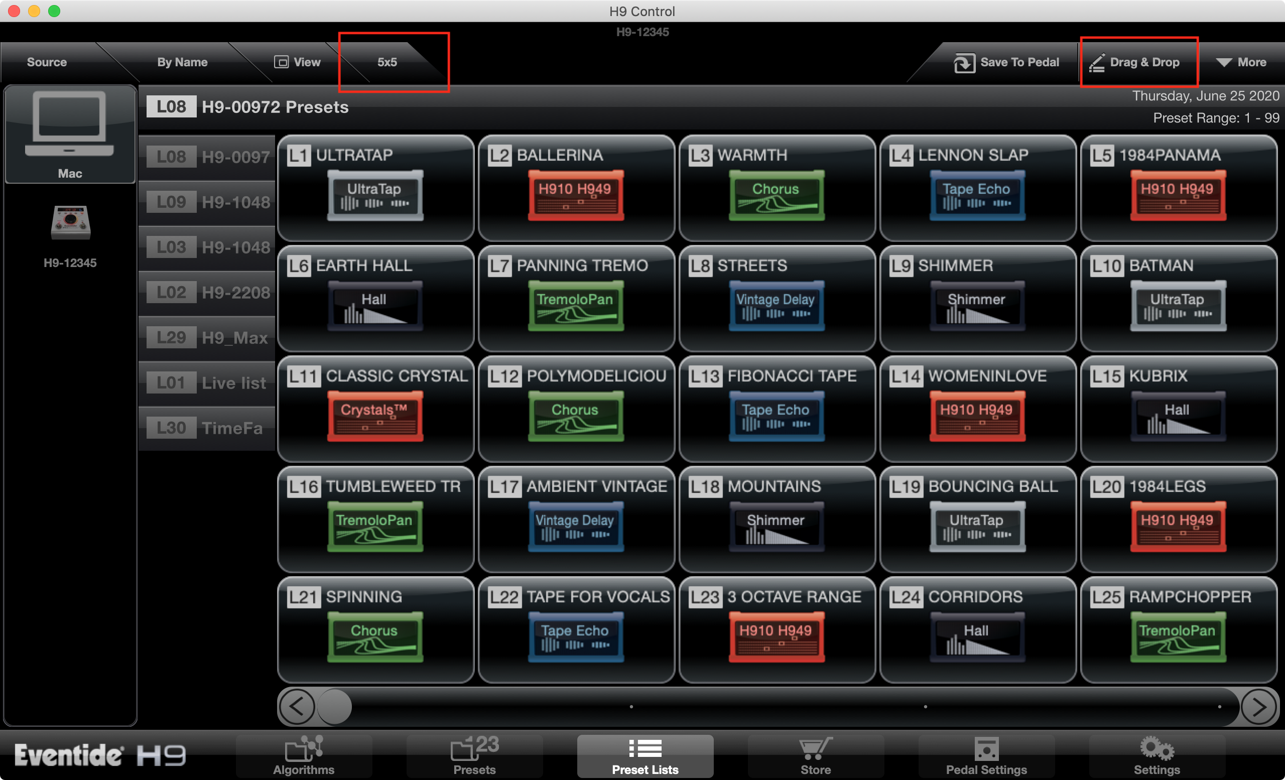

1. See attachement 1 (5×5 grid & drag & drop), where you can change the view to a 5×5 grid.
2. You can click "Drag & Drop", where you can just drag & drop presets

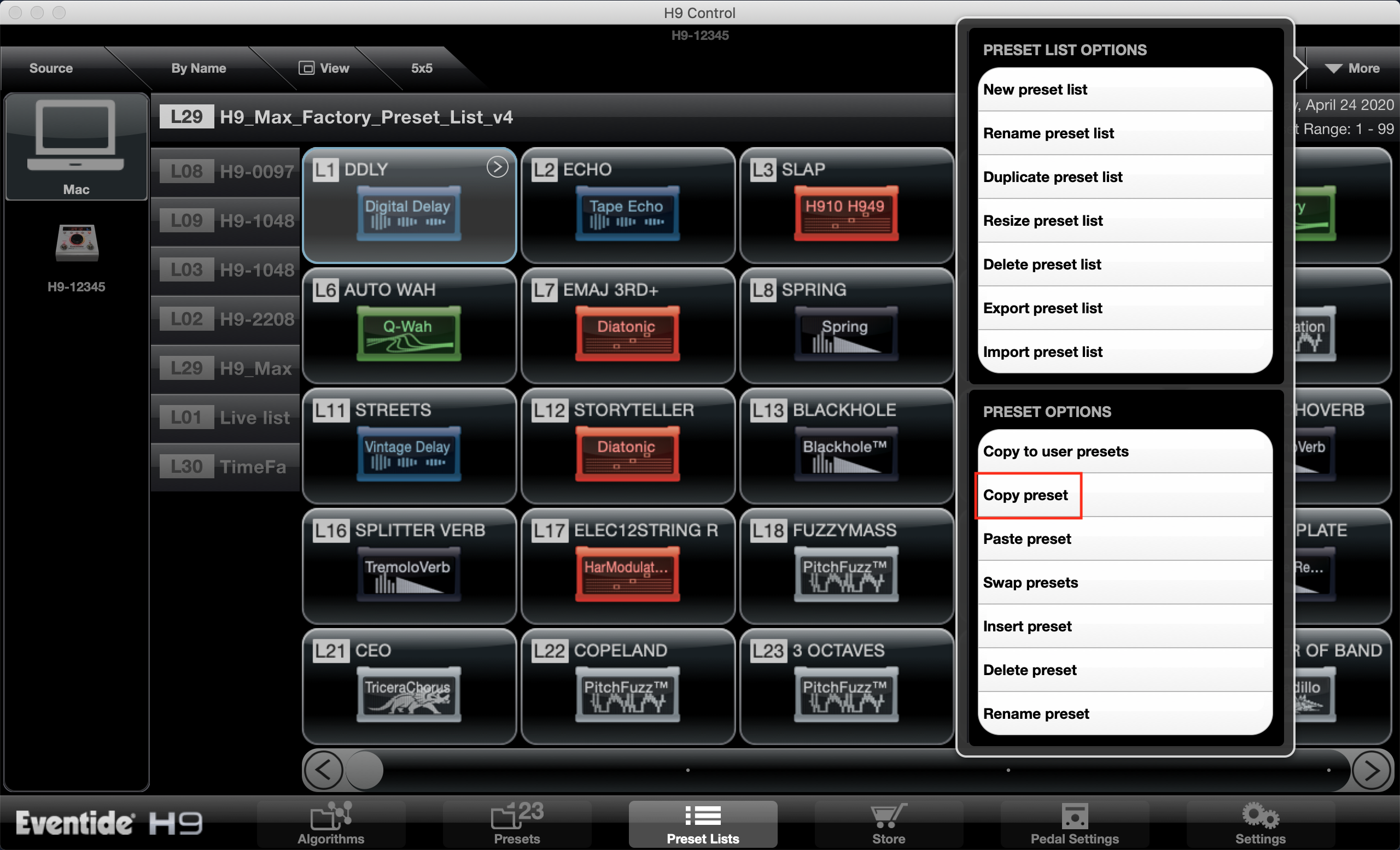

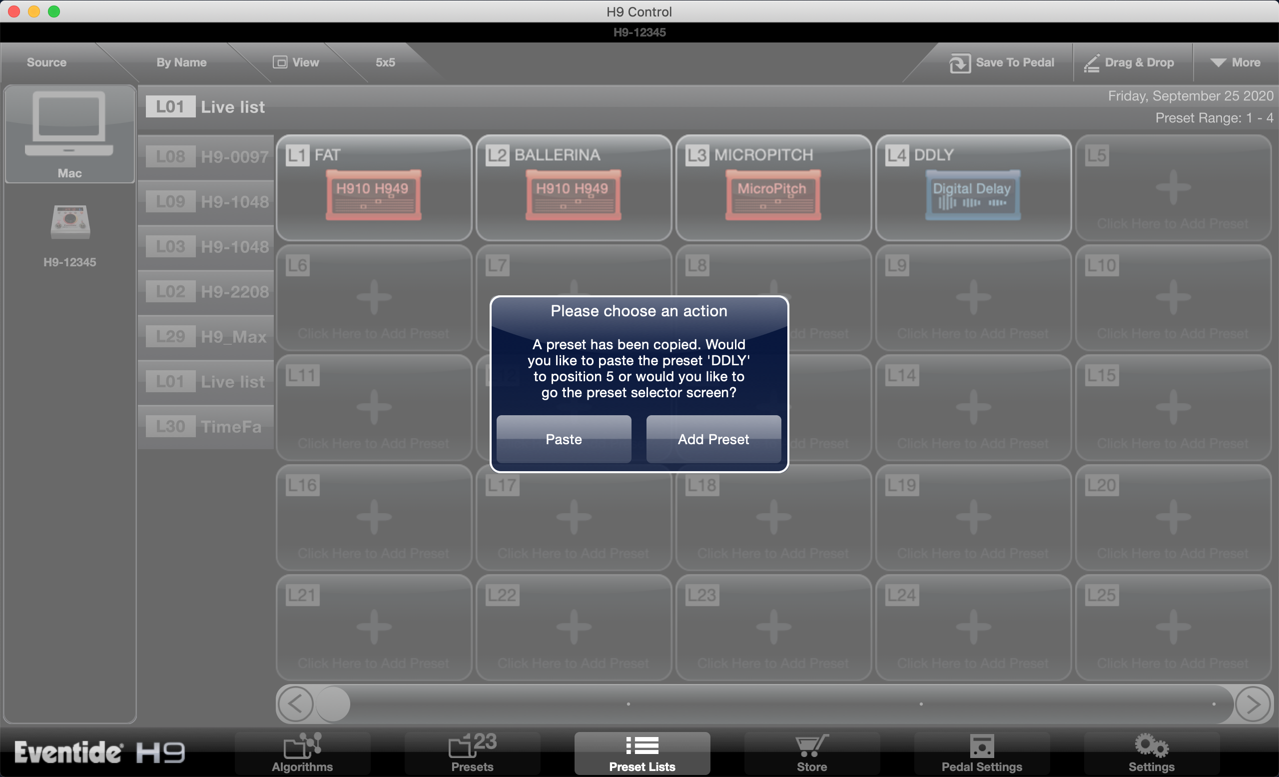

3. See attachment 2 & 3 (Copy preset, Save preset), where you can copy a preset from a list, and save it to another list.
2. You can click “Drag & Drop”, where you can just drag & drop presets
