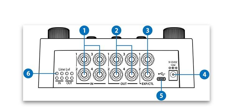

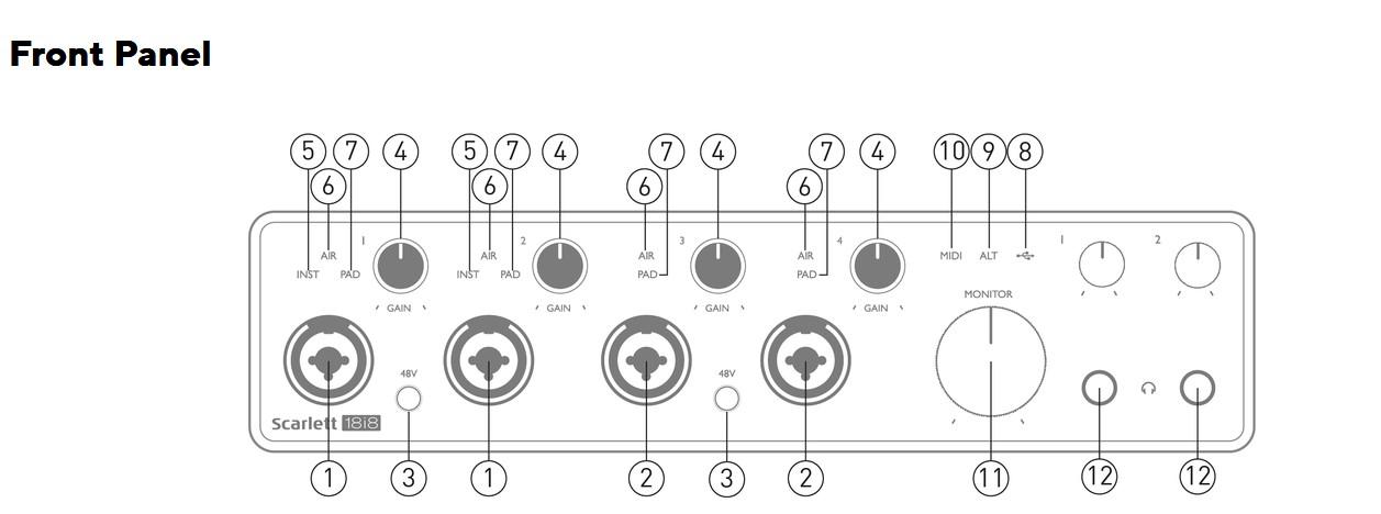

        I want to use my H90 as an external effects processor with my DAW. I’m currently using Ableton Live Lite and would like to create a stereo send/return path.
        I’m using an audio interface and want to route audio from Ableton to the H90, process it there, and then send the stereo signal back into Ableton.
        Could someone please explain the setup step by step?
        Which outputs on my audio interface should I connect to which inputs on the H90?
        Which outputs of the H90 should go back into which inputs on my audio interface?
        Which input/output configuration should I select on the H90?
        And how should I set up the routing in Ableton Live?
        I’ve read through the manuals and tried several input configurations, but I still can’t seem to get my head around the correct routing. I’d really appreciate some help.

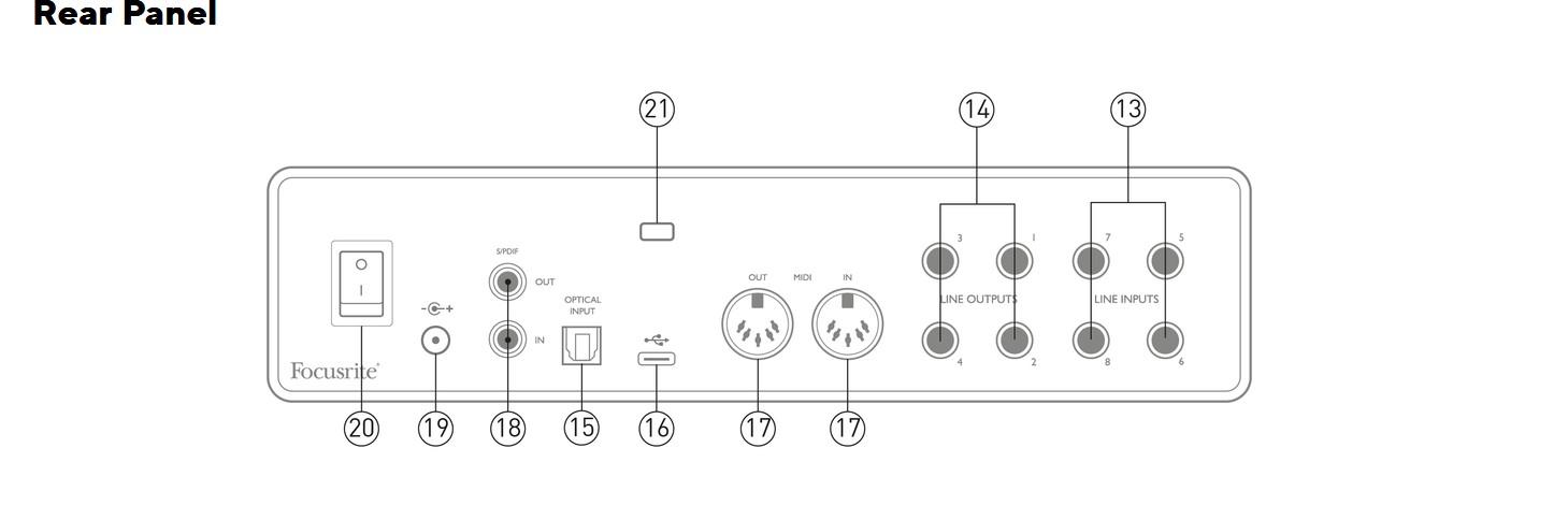

          This depends on what you’re trying to achieve and what your current configuration is, but for a simple stereo send/return you do not need to use Dual Mode. You can use any available outputs on your 18i8 to send audio into inputs 1&2 on the H90, and then run outputs 1&2 from the H90 back into any available input on the 18i8. You will need to do some configuration in the Focusrite Control software to avoid creating a feedback loop.
          I would suggest sending outputs 3&4 on the 18i8 into inputs 1&2 on the H90.
          Since you’re using inputs 1&2 you can then send outputs 1&2 from the H90 into line inputs 5&6 on the rear of the 18i8.
          You should use the default Insert Mode, and switch your I/O to Line Level. Just press and hold the Programs and Routing buttons down for a second to access the System Menu, and then scroll to I/O, press Select, and change In Levels and Out Levels from Instrument to Line.
          First, you need to configure your Focusrite Control software. Assuming you’re using Focusrite Control 2 you will want to change the source for the outputs you chose (3&4) from Mix or Analogue inputs to Playback (DAW) and choose Playback 3-4. Then, in Live go to Preferences, click Audio, then click Input Config and make sure inputs 5&6 are enabled and named, then click OK and to go back and click Output Config and make sure outputs 3&4 are enabled and named, then click OK. Once that’s set up just go to Audio Effects in the Library column and grab an External Audio Effect and drag it onto an unused Return Track (Return C, for instance) in Live, and make sure you select 3&4 in the ‘Audio To’ field, and 5&6 in ‘Audio From’ field. Now, anything you send to Return C will be sent through the H90 and back into Live. You can set the Return track up to be Pre or Post, whichever you prefer. Next, in the Options drop down menu in Live, make sure you have the Delay Compensation option enabled. Lastly, since you wish to use a Return in Live, go to the System menu in the H90 and under Global turn to Page 2 and set Kill Dry to On. This will ensure that the H90 only returns the wet signal back to Live so you can blend this in with your tracks.

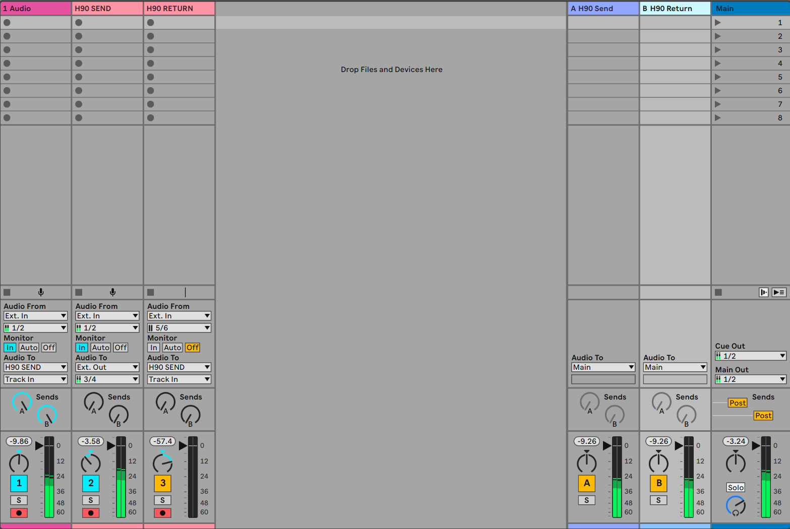

              While I would definitely suggest upgrading to Ableton Live Standard or Suite, there is a way to do something similar using only the Focusrite Control software and Live Lite. In the routing tab in Focusrite Control 2, assign outputs 3&4 to Playback 3-4. Then in Live route the output of your source track to Ext. Out 3&4, then create a second audio track set Ext. In to 5&6 to record the wet H90 signal. There will be some latency with this method, so you would want to monitor through the 18i8, and choose ‘Off’ under the Monitor section on the wet H90 track. You can also use the Track Delay slider in Live to nudge the track around and align it with the source material and the rest of your session. You can also enable Kill Dry in this configuration to record only the wet signal from the H90, and blend the dry signal with the recording after the fact.

                MJJBVDH87
                  Al.ost there. What isn´t right? thnx so much/
                  Live Send return h90
              • #199270
                MJJBVDH87
                  Almost there. What isn´t right? thnx so much. @mcasenLive Send return h90[/quote]
                • #199299
                  mcasen
                    On Track 1 the ‘Audio To’ should be routed to Ext. Out 3&4, and on ‘Track 2’ the Audio From should be routed to Ext. In 5&6. This way all of the dry audio recorded on Track 1 will be sent through the H90 and back in to Live on Track 2.
                    If you’re recording a live performance through inputs 1&2 on the 18i8 then you would just need to set up the 18i8 so the source of Output 3-4 is Analogue 1-2. Then in Live you’d just need to set one track to record Inputs 5&6.
                    I would also suggest reaching out to Focusrite directly for tips on how to best use their hardware and Focusrite Control software with your setup.
                    • #200120
                      MJJBVDH87
                        @mcasen Which tracks do you mean? The Return Tracks on the right or the tracks H90 Send and H90 Return on the leftn next to AUdio 1.?
