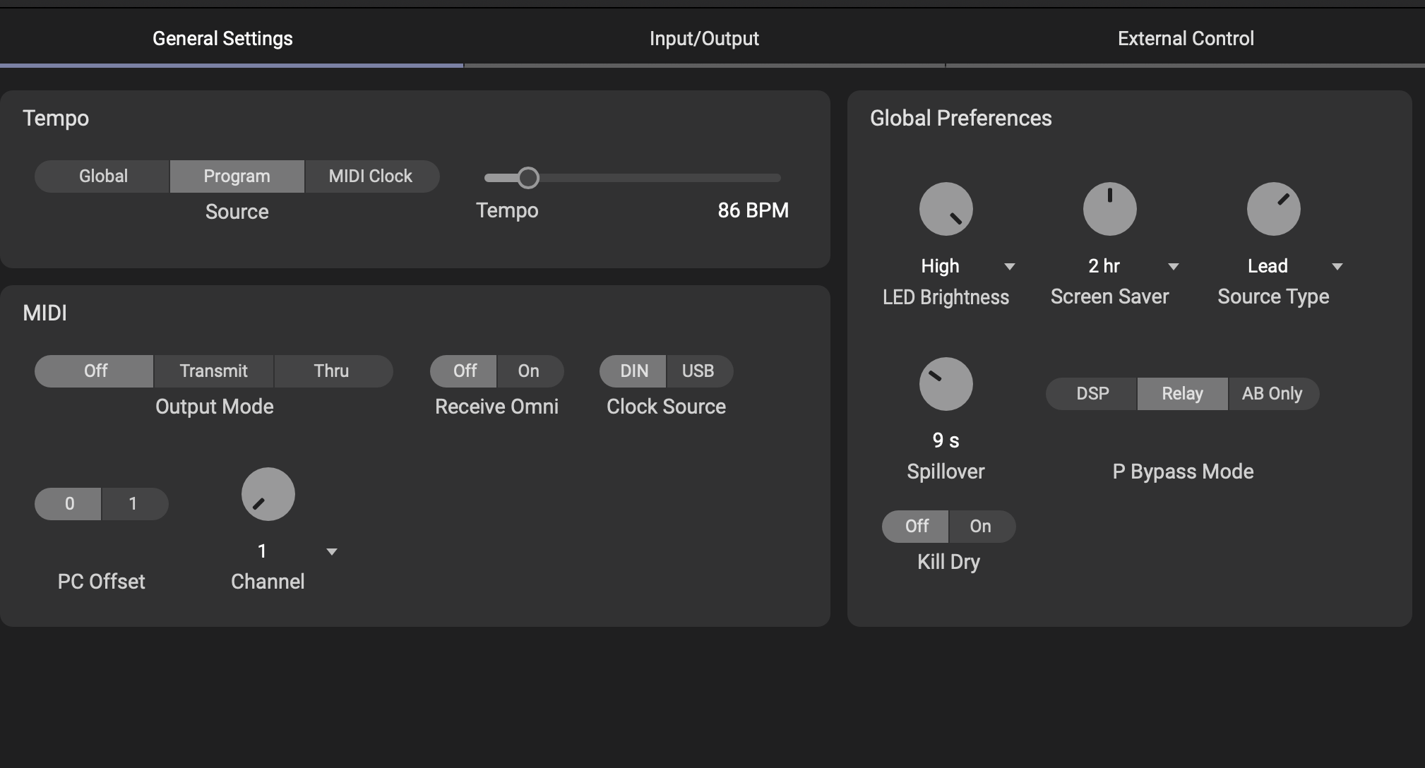

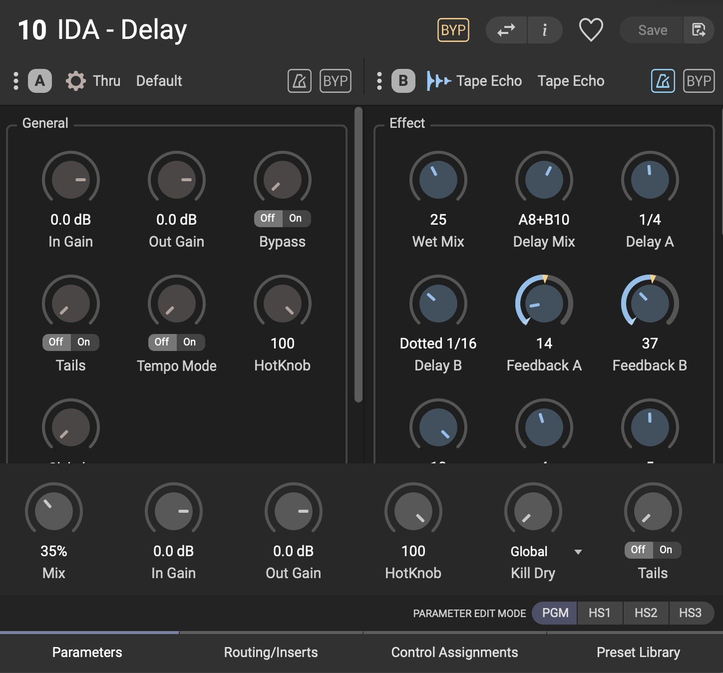

        Hi there, I’ve attached a video showing my issue but – in short, there’s one program I made where ‘spillover’ doesn’t seem to work. When I load up this program, the active button blinks as per normal – but then when I click the active button in order to lock in the program, the program turns off – killing the effect from the last program and killing my momentum.
        Any idea what might be happening here? I have latest firmware, am not connected to MIDI or bluetooth. I’ve attached a screenshot of the culprit program as well. Screenshot 2026-01-04 at 3.17.54 PMScreenshot 2026-01-04 at 3.18.07 PM

            Try switching your P Bypass Mode from Relay to DSP.

              It looks like you saved the Program in the Bypassed state. So when you load the Program, the pedal gets bypassed. It sounds like that is not intentional.
              Try loading the Program, making the Program active by pressing the P footswitch, and then save the Program again while it is active.
            • #194202
              gabegladstein
                Thank you both – @tbskoglund you nailed it! Fixed 🙂 thank you
