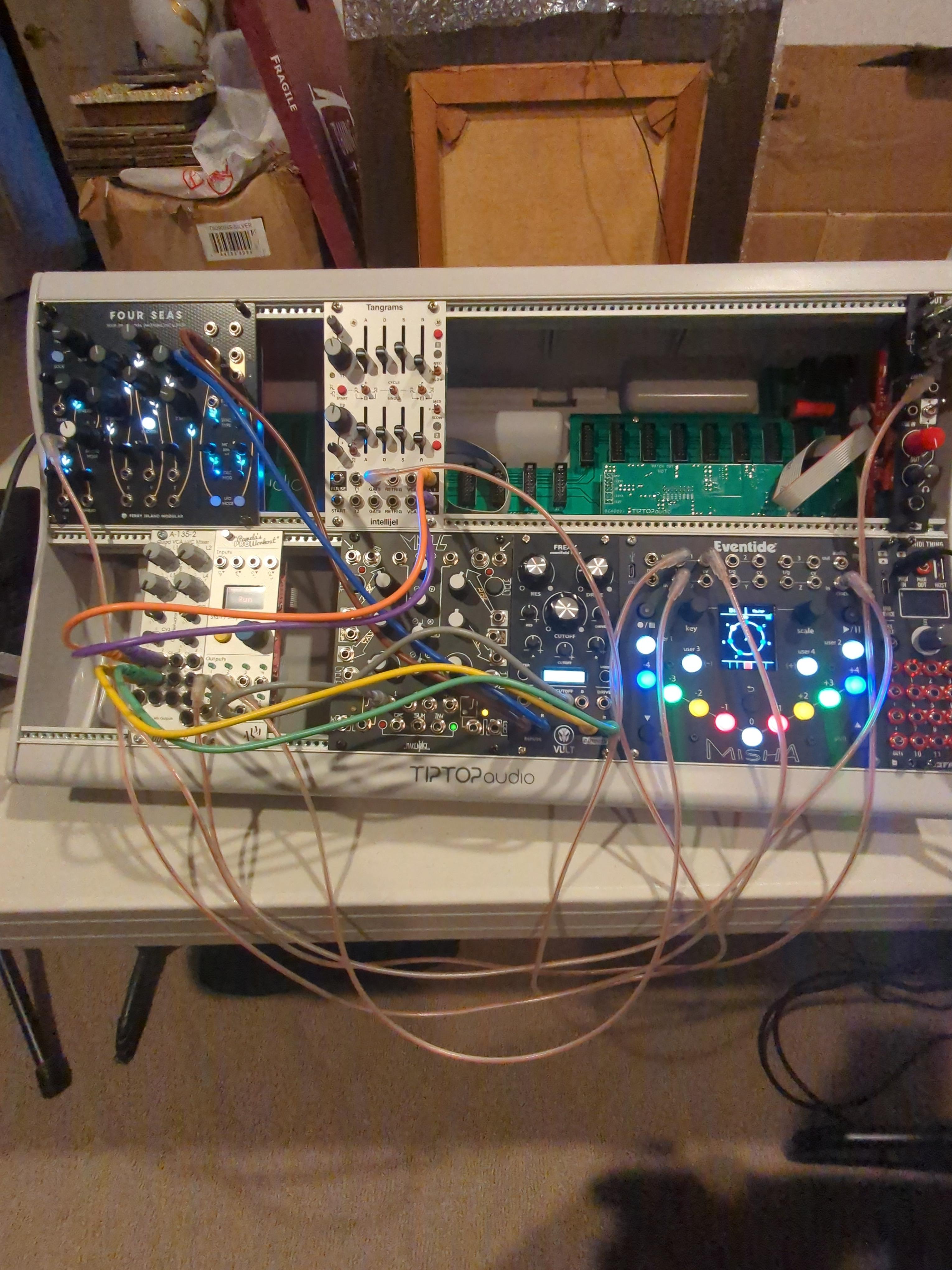

        hi.
        does any one know how i can setup the pam pro workout and the misha to start at the same time. i want to hit the start on the pam to trigger the play button on the misha.

          Hello,
          I don’t have a Pam Pro to test this, but are you able to fully stop/start the clock output?
          If Misha isn’t receiving any clock, then the sequence won’t proceed. So, if you can stop/start the clock from Pam, then that should be a way to trigger the Misha sequence on/off.
          Or, you could send a gate out of Misha to the Pam “run” input. Then when you press play on Misha it should also run the Pam.

            djkevid
              this is the patch i have set up. i can start and stop misha with the pams but the green light on the play and pause button doesnt light light also when i hit start on pam the user 1 light isn linked to the time of the beat
