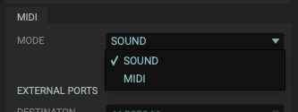

      • #194738
          Hello,
          Please go to the Preferences tab and make sure the Mode is set to “Sound” and not “MIDI”.
          Screenshot 2026-02-23 at 10.51.10 AM
          Let me know if that resolves the issue.
