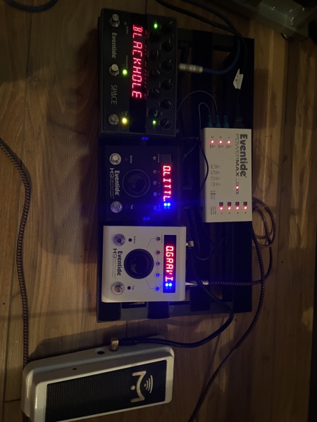

I am in the process of a pedal setup mainly for studio purposes with 3 H9 (still waiting to receive 1) and a Space at the end of it.
I had them connected all over the place on any power outlet I could find using the factory power source that came with them.
I just got the Powermax V2, and after switching I start getting a strange hiss out of my speakers, I do not know if there’s anything special about the connection, besides using the green center positive cables.
Honestly I’m scratching my head to find the issue, so I do not know what other details to provide, I uploaded a Picture in case it helps… Any help is appreciated!
February 26, 2021 at 4:48 am #157267tstern wrote:
What kind of speakers are you using? You should make sure that your pedalboard is plugged in to (as close to) the same outlet as your speakers/amplifier to reduce the risk of ground loops.
KRK Rokit5,
On the connections I thought that I was improving because I moved from several outlets to the powermax directly into a furman in my rack, but I’ll dig into it, I switched some things and it did improved, I agree, it seems sometimes electricity has a mind of his own.
tstern wrote:The next step is to remove power from your board. If (as it looks) you’re just using Eventide pedals, they will all relay bypass when you unplug them, so you should still get audio through them.
I got the Space stombox recently and it just grew to an expermentation pedal board for sound design, my plan is 3 H9 and the space at the end, only thing I am also planning to add a jhs color box, to use pre and post.
tstern wrote:Lastly, you can start removing pedals from the loop to track down whether it’s one specific pedal having an issue. Basically, the goal is to simplify until you find the one change that makes the hiss go away.
