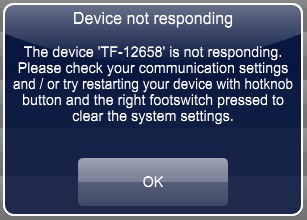

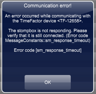

        I’m having lots of issues getting these two work together. I’m on Win 10. H9 control is constantly unable to connect to the timefactor.
        I’ve tried restarting it & clearing the settings. I can get it to connect some times but it’s very inconsistant.
        Any suggestions?
        Cheers
        Mike
