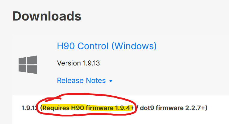

        I’m trying to update my H90 and found this downloads page: https://www.eventideaudio.com/downloads/?product=H90+Control
        I can’t get that version to connect to my H90.  I see it says that version of the software requires firmware 1.9.4 which I don’t think I have.  When I look in the about page on the H90 I see a bunch of numbers but none is labeled “firmware”.  However, I also don’t see anything labeled “1.9.4” so I’m assuming I don’t have 1.9.4.  I’m also assuming mine is older because I bought it a few years ago and have never updated the firmware.
        So if that software requires firmware 1.9.4 there must be some way to update the firmware without that software for people who don’t have firmware 1.9.4 (right?).  But I can’t find the firmware download or instructions on how to install it WITHOUT that software.
        Can someone point me to instructions on how to update the firmware WITHOUT the H90 control software that seems to require a firmware version that I don’t have?

            My H90 does not show up when connected.  The link I provided above says that version of the H90 control requires firmware 1.9.4, which I don’t think I have.  Presumably that is why it doesn’t show up.
            I need the 1.9.4 firmware update.  I can’t find that.

            rgames
              Screenshot 2025-12-21 001820

                  Website says to use H90 control to update the firmware but the website also says H90 control requires firmware I don’t have.
                  I’m finding it difficult to make any sense of that combination of instructions.
