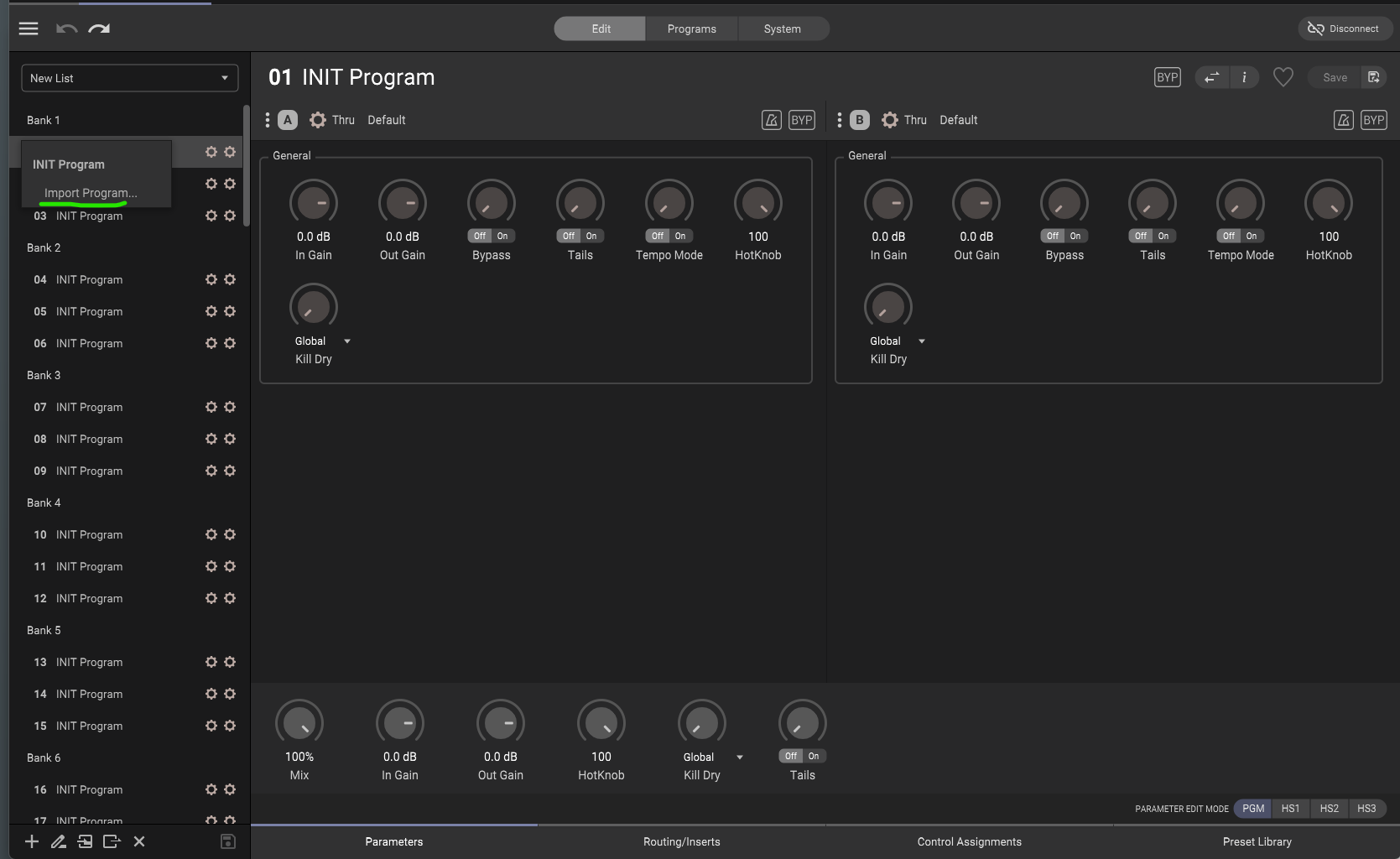

            I’m sorry you’re having trouble.  To import a Program (from a pgm90 file) in H90 control, load the program list you want to import the program to, then open the three-dot menu next to the slot you want to load to (on the left-hand side) and select “Import Program”
            Screenshot 2026-02-16 093817
