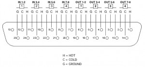

      Tascam TDIF / AES / EBU

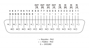

      Yamaha AES / EBU

      The H9000 uses the Tascam standard.
