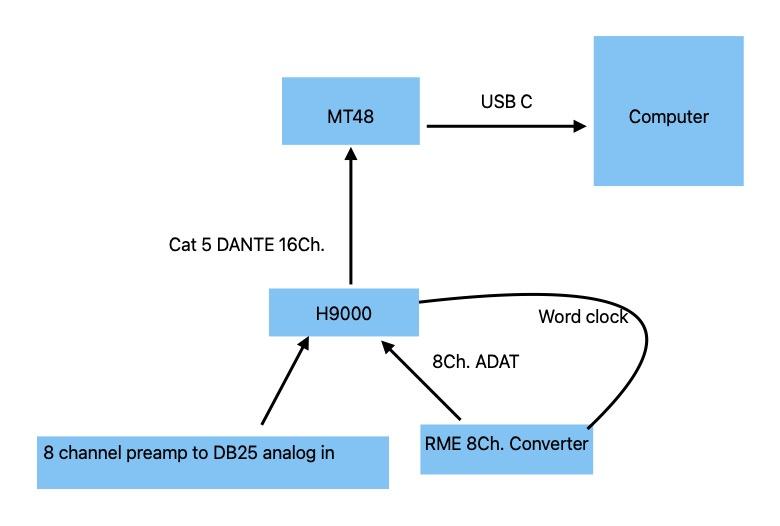

            • #191620
              jerzythepeddler
                Here’s a super quick diagram. But I think it gives you an idea. Basically I’m trying to use DANTE like a glorified ADAT optical cable, that can handle more channels and it can be a longer cable.
                So I’m not using the DVS, but the MT48 acts as a DANTE interface over USB C. This should also allow me to use the internal mixer of the MT48 to set up headphone mixes with DANTE inputs too.
                Thanks!Diagram

                • #191728
                    Hi there,
                    Sorry for the late response, but yes, this setup looks like it should work just fine.
                    You’ll just need to configure all of the I/O routing using both the H9000 (Direct I/O or FX Chains) and Dante Controller.
                    Let me know if you need further assistance.
