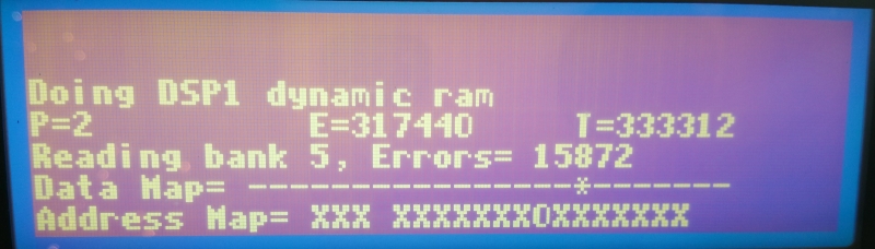

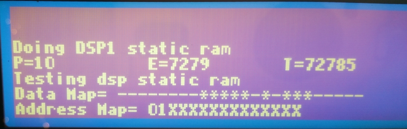

        DSP1 Static Ram
        Address Map = 01XXXXXXXXXXXXX
        DSP1 Dynamic Ram
        Address Map = XXXX XXXXXXX0XXXXXXX

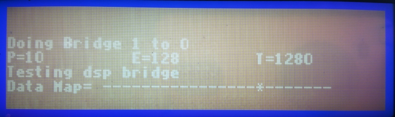

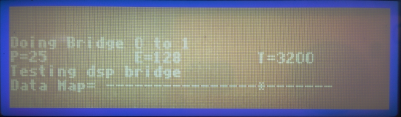

        E Bridge 0 to 1
        E Bridge 1 to 0

          Obviously, kinda hard to know from here, but these messages do suggest that either DSP1, or more likely communications to it, are dead. I would suggest that you try wiggling all socketed parts, and if that fails, go to
          Legacy Product Repair Information | Eventide (eventideaudio.com)
