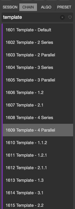

        In some scenarios, I would be wanting to run 16 algorithms seperately. so they don’t bleed into each other. As these algorithms are predominately stereo, I would look to route 32 MADI channels in pairs (NOT stereo linking BTW!) to 16 algorithms. So, in each FX chain, I would need to have 4 algorithms in parallel, and routed to a total of 2 channels per algo, i.e: 8 channels of MADI. Is there a MADI template I can download for this?

          There are many Factory FX Chain templates that can be found in the 1600 bank as seen below. The 1609 template I have highlighted gives you 4 algorithms in parallel, though you will need to route the hardware outputs of your FX Chain for your workflow and setup.
